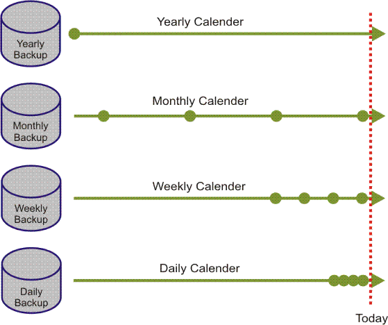

In the figure below, the red dots represent a state backup. The further back the consideration, the fewer the number of backed up states that are taken into account. The logic behind this mechanism is the assumption that recalculation is usually required for the time period closer than one month back.
