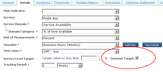

Dynamic targets are handled by the Business Logic using an event handler in the standard Business Logic script, similar to the Result() function which is used to the return the service level value from the Metric. The Dynamic target must be specified on the Metrics 'details' tab as shown below.
Implementing Dynamic Targets
When a dynamic target is specified then the target is taken from the 'Target()' function in the Business Logic, rather than the static value specified in the Details tab of the Metric. The Target function looks like the following.
