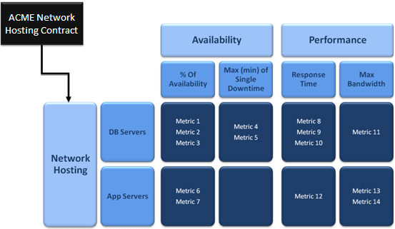

Once the process of identifying all Metrics and their related entities is complete, the Contract Manager has a matrix that describes all of the Metrics as shown in the following diagram.
The Modeling Process
The Modeling Process - example
