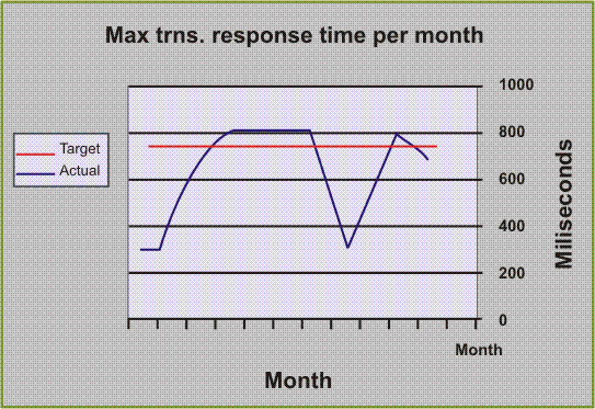

The following figure depicts a typical report under these circumstances.
Any transaction that exceeds the target will be regarded as a breach of contract, but as a base for understanding the actual quality of service provided it is very poor, as it only reflects a single transaction and nothing is known regarding the rest of the transactions, such as, was it a single failure or a trend? If it was not an isolated incident, then how many failures were there, or what is the ratio of failed transactions to the total number of transactions performed during the month? There may be a number of months with such occurrences and hence a breach of contract, but what is the trend? Is it improving or getting worse? All of these are questions that the Service Level Manager might ask and the report should be able to provide the answers.
Note: When defining the Metric and its associated calculation outline, it is very important to envisage how the results will appear in a report. This report must provide two crucial items:
