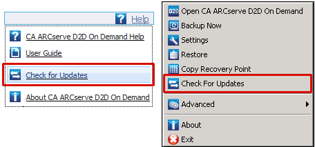

    2. The check for updates can be launched manually from the CA ARCserve D2D On Demand Help menu or from the CA ARCserve D2D On Demand Monitor.
    Check for Updates

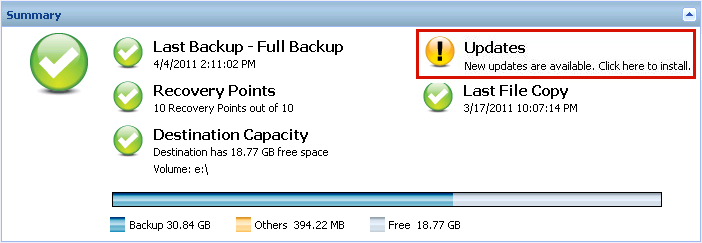

    A yellow Updates icon is displayed on the home page to provide a visual indication that a new update is ready to install.
    Note: Update status balloon messages are also displayed from the CA ARCserve D2D On Demand Monitor.
    home page - summary panel 2

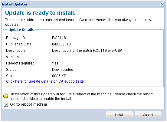

  3. Click the Updates icon.
    The Install Updates dialog opens to display information that is related to the available update. The dialog includes information such as description, download status, size, reboot requirement, and a link to the CA Technologies server for additional update details.
    APM cad2d--Update Details Dialog-W
  4. Review the update details, select whether it is OK to reboot the computer, and click Install to trigger the installation of the CA ARCserve D2D On Demand update.
    The new update is installed in your local computer. If the update requires a reboot and you selected the "OK to reboot machine" option, the computer reboots automatically as part of the install process. Depending on the update status of each computer, you could have different reboot requirements for each computer.
    Note: If the update requires a computer reboot and you do not select the "OK to reboot machine" option, the Install button is disabled. You can then install the update at a more convenient time.
    Note: During installation of the update, CA ARCserve D2D On Demand stops the D2D web service and connection to UI is lost.
