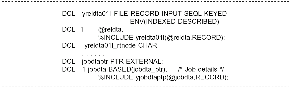

VNM CHR PTR
Name control variables based on files and data structures by the based-on structure name and a suffix:

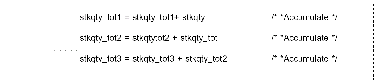

For the names of fields that act as accumulators, use an appropriate prefix or suffix appended to the name of the field being accumulated. This helps to make the mapping of a field from format to format, clear. For example:
