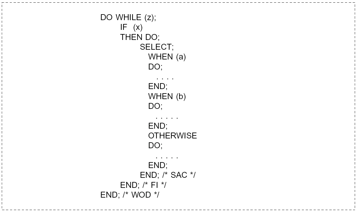

Structured programming operations should be used where possible. For example, use IF rather than GOTO. The corresponding END and ELSE statements should indicate the matching operations by means of comments.

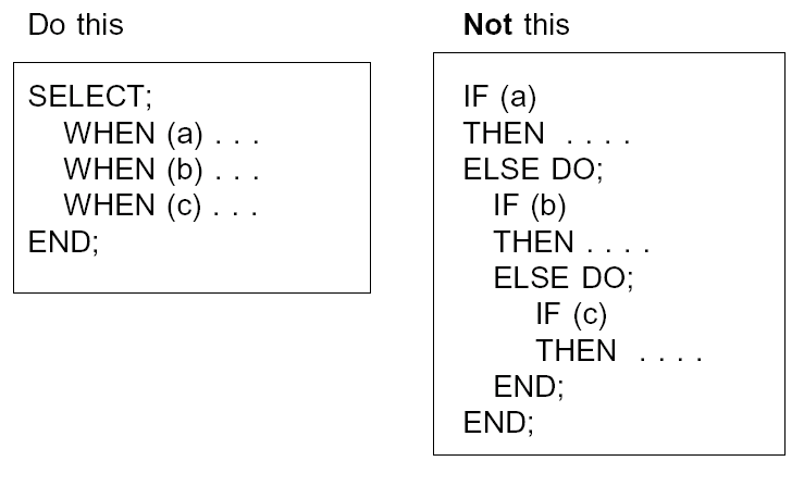

Use SELECT structures in preference to nested IF/ELSE statements— they are easier to follow:
Note: Avoid nesting structured programming operations too deeply, such as more than four or five levels of nesting in a given procedure level. If more are needed, use another procedure.

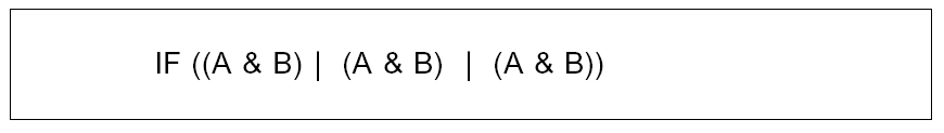

Avoid testing compound negative conditions when possible—they are harder to understand, for example, not:
