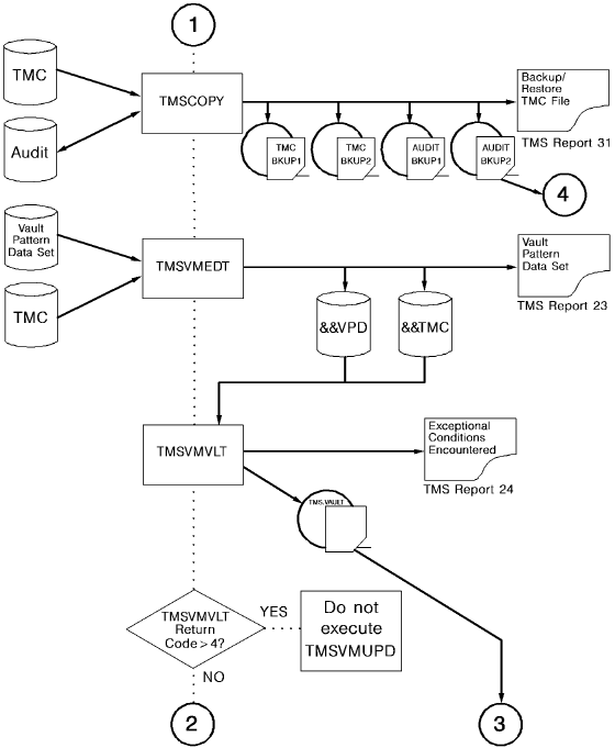

The Sample Daily Batch Processing Flowchart illustrates the sequence in which many of the utilities should be executed.
Note: For a report cross-reference see the Utilities and Reports Reference Guide. Source member EARLINDX lists and describes each CA Earl member.
The following is a Sample Daily Batch Processing Flowchart (1 of 3):

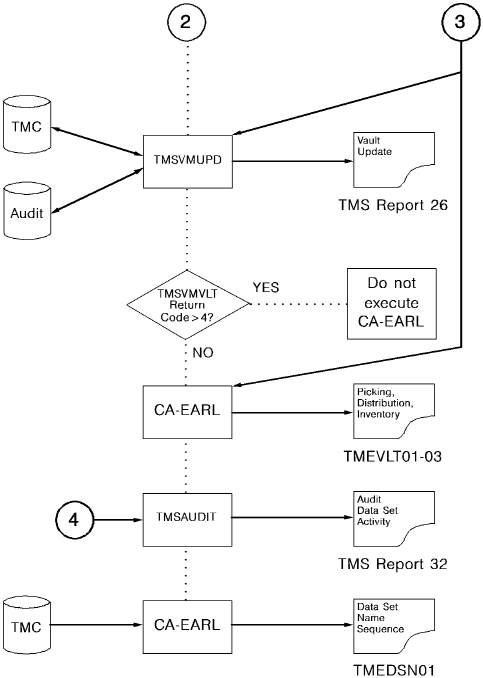

The following is a continuation of the Sample Daily Batch Processing Flowchart (2 of 3):
The following is a continuation of the Sample Daily Batch Processing Flowchart (3 of 3):
