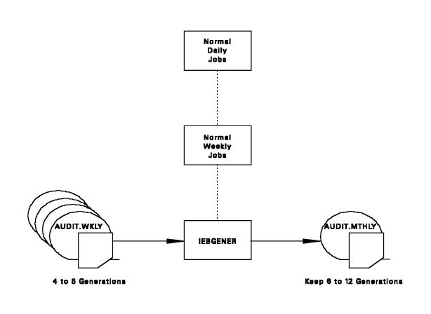

Create a monthly tape of cumulative Audit data. Add an additional step to your normal weekly maintenance job stream.
IEBGENER
Concatenate the weekly Audit data set backups that are created by TMSCOPY in chronological sequence as input to IEBGENER or a similar utility. Copy the backups to a single file to create a monthly maintenance tape. Always have from 6 to 12 months of Audit data available.
The following is a sample Monthly Batch Flowchart:
