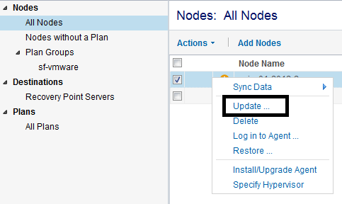

You can resolve this issue by manually updating the node from the Console.
Follow these steps:
resources
tab on the Console.All Nodes
.All the added nodes are displayed on the center pane.
The node is updated and the plan is refreshed.
