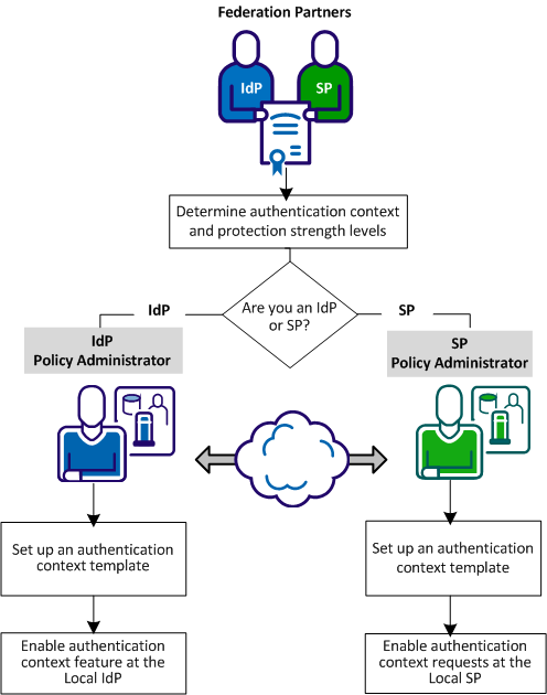

‑The following figure shows the configuration process for each partner. CA SiteMinder® Federation does not have to be installed at each site.
Complete the following steps to configure authentication context processing:
The SP can require specific authentication contexts and strength levels before it permits access to a requested resource. Based on the sensitivity of the resources at the SP, the SP has to have confidence in the assertion it receives from the IdP.
The administrators at the IdP and SP have to establish guidelines for supported authentication contexts and the relative strength of each authentication context URI. The order of the URIs at the IdP together with the associated strength levels affects how the IdP responds to the SP.
For example, an SP requests an authentication context for an X.509 certificate and a comparison value of exact. The IdP has to authenticate the requesting user at a suitable strength level and satisfy the comparison value during the evaluation of the authentication context.
