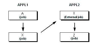

Example: Synchronize Applications
Suppose that job X in APPL1 runs with an unpredictable frequency, and you want the server to complete external job X in APPL2, if job X in APPL1 ran in the past 24 hours or is scheduled to run in the next 24 hours. The following illustration displays the dependency between the two Applications:
You would create two Applications as follows:

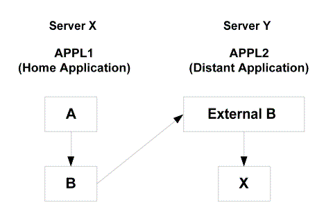

Example: Set Up a Dependency Between Two CA Workload Automation DE Systems
Suppose that job X defined in Server Y depends on job B defined in Server X. Server X runs the home Application to submit job B. The following illustration displays the dependency between the two CA Workload Automation DE systems.
Note: For more information on integrating two CA Workload Automation DE systems, see the Implementation Guide.
