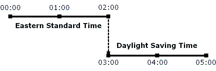

In the North American Eastern Standard Time Zone, DST starts on the second Sunday of March at 2:00 a.m.; the time springs forward one hour to 3:00 a.m. The following illustration displays DST spring forward:
Events that are scheduled to run during the spring-forward transition period (2:00 a.m. to 3:00 a.m. on the day spring forward occurs) run immediately after the transition at 3:00 a.m. For example, Event A is scheduled at 2:30 a.m. on March 11, 2007. At 01:59:59 a.m., the time springs forward to 3:00 a.m. At 3:00 a.m., the server considers Event A overdue and triggers the Event immediately.
