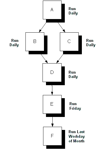

Example: Dependencies between jobs in an Application
Every day, jobs A, B, C, and D run. On Fridays, job E runs. On the last workday of the month, job F also runs.
The following illustration displays the run frequency of all the jobs.
The server submits a job after all of the job's predecessors complete successfully. In this Application, the jobs run in the following order:
