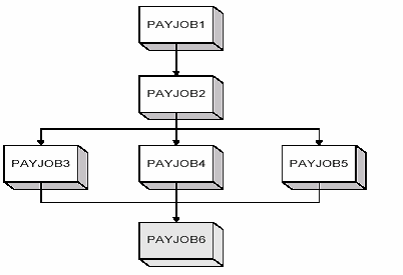

Suppose that PAYJOB6 should start by 7 a.m. PAYJOB6 has an average elapsed time of one hour.
The following illustration displays the relationship between all the jobs:
When the server generates the Application, it sets late end times for all predecessor jobs, PAYJOB1 through PAYJOB5, based on their historical average elapsed times and the late start time of PAYJOB6. If any job in the preceding Application ends late, the server marks the job with an Overdue condition. If you set up a notification in the Application definition for overdue processing, the server sends a notification whenever a job becomes overdue.
In this example, PAYJOB6 has a late start time of 7 a.m., which means PAYJOB3, PAYJOB4, and PAYJOB5 must end by 7 a.m. If PAYJOB3, PAYJOB 4, and PAYJOB5 each have an average elapsed time of one hour, then they will each have a late start time of 6 a.m., and PAYJOB2 will have a late end time of 6 a.m. If PAYJOB2 has an average elapsed time of two hours, then PAYJOB2 will have a late start time of 4 a.m., and PAYJOB1 will have a late end time of 4 a.m. If PAYJOB1 has an average elapsed time of 30 minutes, then PAYJOB1 will have a late end time of 3:30 a.m.
