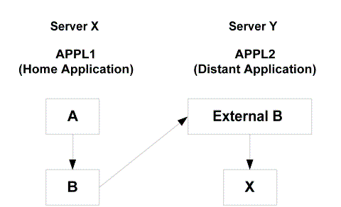

Suppose that job X defined in Server Y depends on job B defined in Server X. Server X runs the home Application to submit job B. The following illustration displays the dependency between the two CA Workload Automation DE systems.
The diagram shows the relationship between the home Application on server X and distant Application on server Y.
You would create two Applications as follows:
