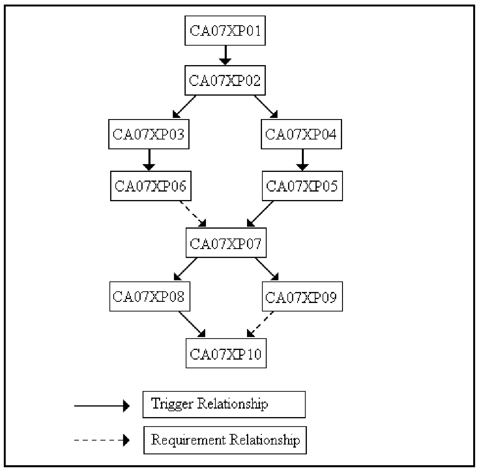

DEMAND,JOB=CA07XP01
This command causes the execution of the first job in a cycle whose completion triggers subsequent jobs. You can monitor the execution of these jobs by issuing the LQ command every few seconds, noticing how the display changes. After the jobs are completed, you can issue the LRLOG command to see the history, and optionally issue the LPRRN command.
