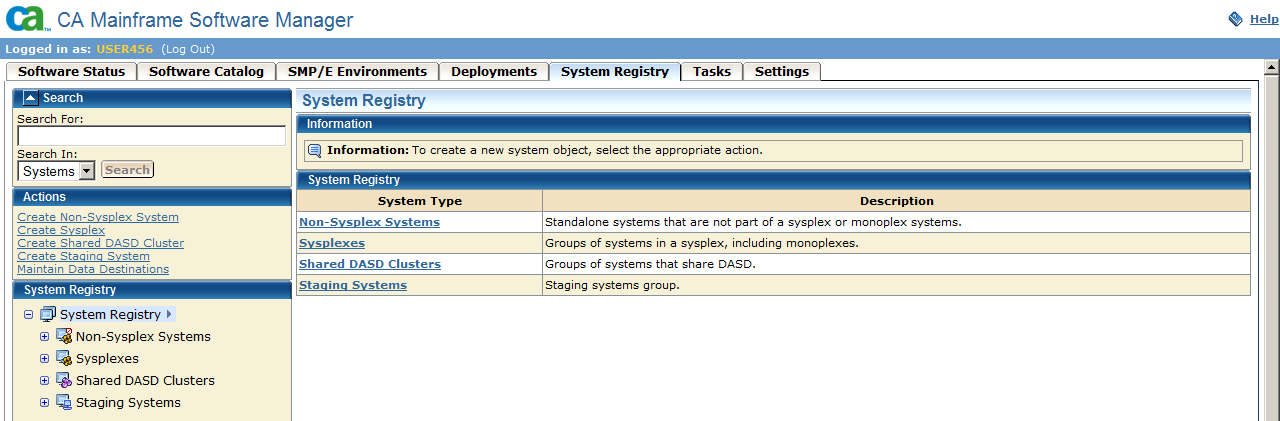

View a System Registry
You can view a system registry by using the CA CSM.
Follow these steps:
  1. Click the System Registry tab, and select Non-Sysplex Systems, Sysplexes, Shared DASD Clusters, or Staging Systems from the tree on the left side.
    Information about the systems that you selected appears on the right side.
    Systems Registry Tab
