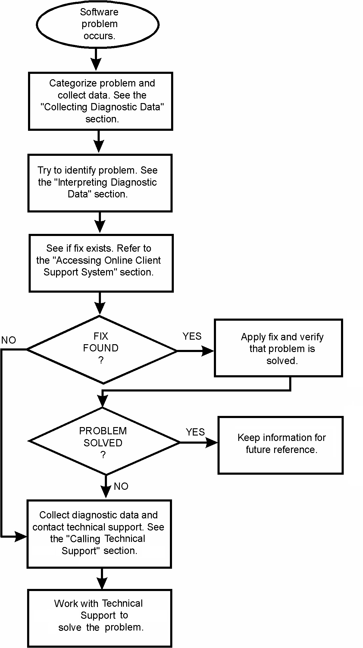

Refer to the following flowchart for a summary of the procedures you must follow if you have a problem with a CA software product. Each of these procedures is detailed on the following pages.
