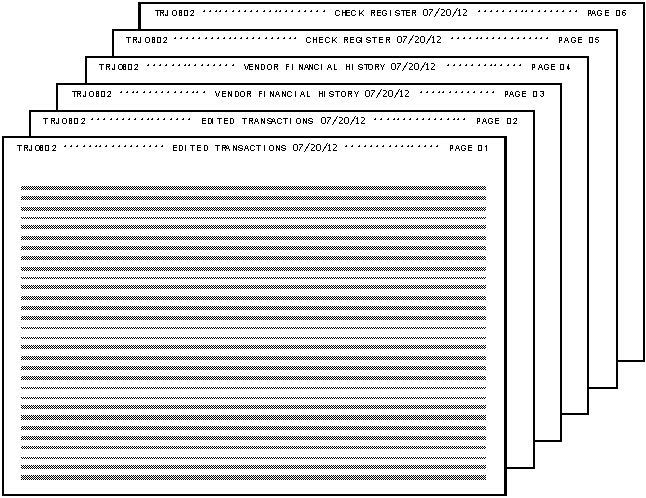

The reports for the job discussed in this chapter are comprised of exclusive segments. For example, the edited transactions from TRJOB02, the vendor financial history, and the check register, all form unique and exclusive segments, as shown in this illustration.
These portions of SYSOUT data are not selected again for processing in any other report. (Note, however, that it is possible to define reports that contain more than one exclusive segment each.)
When you define exclusive segments, you only have to identify the beginning of a segment; the end of the previous segment is automatically delimited by the beginning of the next one.
In this example, the first line of the first page of each segment contains a unique title. This title is an excellent text string to use for report identification.
The targeted text strings are the words EDITED from the first title, VENDOR from the second title, and CHECK from the third.
