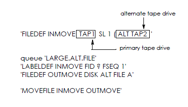

Writing a File to Disk Using an Alternate Tape Drive
This EXEC reads the data set LARGE.ALT.FILE from tape and writes it to the file ALT FILE on your A disk. Again, the EXEC identifies an alternate drive to speed processing.
Writing a File Disk Using an Alternate Tape Drive
