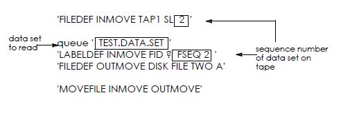

This EXEC reads the secondary data set TEST.DATA.SET from the tape and writes it to the file FILE TWO on your A disk. As with the primary data set, CA VM:Tape determines which tapes to mount based on the data set name and file sequence number of the data set on the tape.
