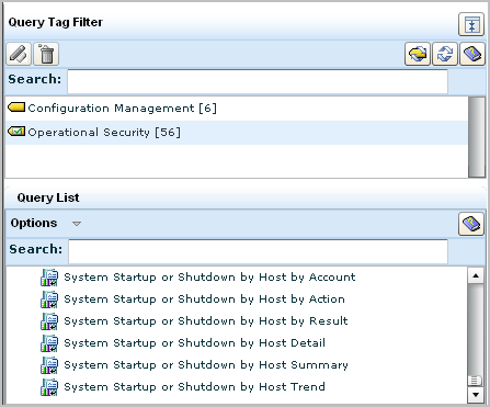

  1. Click the Queries and Reports tab.
  2. Select a query tag filter that matches the Category of a severe event.
    For example, select Operational Security.
  3. Review the query list for queries with names containing keywords found in the Class or Action for the identified event type.
    For example, the keywords System Shutdown appear in queries beginning with the phrase System Startup or Shutdown by Host.
    Select Configuration Management and view queries on the list that begin with System Startup or Shutdown.
  4. Copy the query System Startup or Shutdown by Host Detail. Highlight the query and select Copy from the Options drop-down list.
