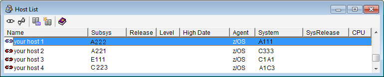

  1. Click the Host List icon (Host List dialog icon) in the main Windows Client toolbar.
    The Host List window opens. The following is a sample of the Host List window:
    This is a screen shot example of the Host List window with multiple hosts defined.
  2. Select the host to which you want to log in to from the Host List window.
    The selected host definition is highlighted. as shown in the following sample.
    The is a screen shot example of the Host List dialog, and one host definition connection is selected

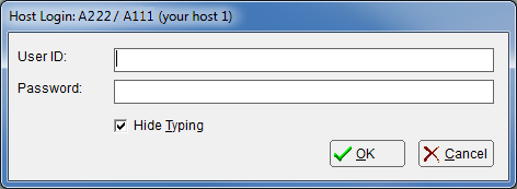

    If your user ID and password were not provided in the Host Definition dialog for the selected host, then the Host Login dialog appears as shown in the following sample dialog, and you must proceed to the next step.
    This is a screen shot example of the Host Login dialog
  4. Enter a valid user ID and password in the Host Login dialog, and click OK.
    The Host Login dialog disappears.

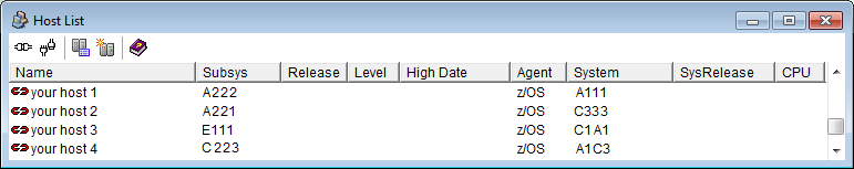

    The Windows Client attempts to connect and log on to the z/OS host. When the connection and log on is complete, the connection icon in the Host List window changes from the Connecting icon (Host disconnecting icon) to the Connected icon (Host List connected icon), as shown in the following sample, and you can begin using CA Vantage GMI.
    This is a screen shot example of the Host List dialog with one host connected.
