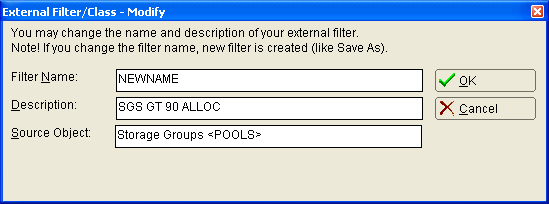

    The External Filters/Classes Manager Modify dialog is displayed. The following is an example of the External Filters/Classes Manager Modify dialog showing the NEWNAME External Filter:
    This illustration is a screen shot example of the External Filter/Class Manager Modify dialog.
  6. You can use this dialog to change the Filter Name and Description. If you only want to change the filter expression, skip to step 6.
    Note: If you change the Filter Name, a new External Filter is created with the new name using the existing External Filter as a template.
