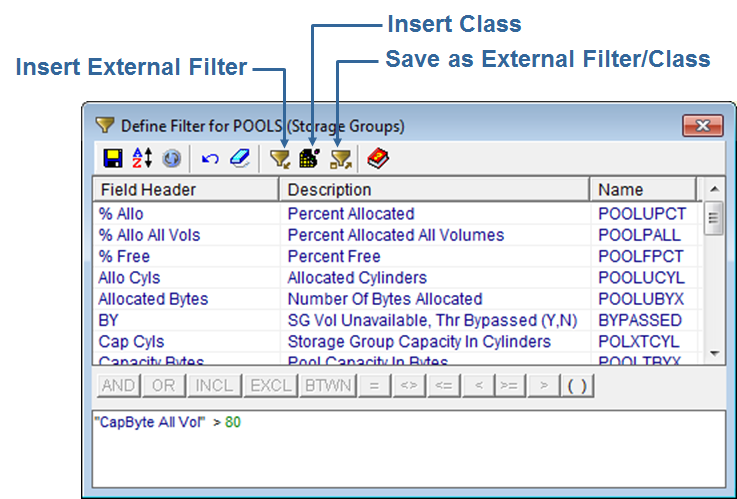

You can also save filters in a common global repository on the z/OS host known as the external filter/class library. Placing filters in this shared library makes them available for reuse by any user. Each shared filter defines a class for a specific object. Any user can copy (insert) a filter string from this library and use it, or simpler yet, they can simply refer to the external filter/class by its name. Any object views or User Views that contain filters that only refer to a filter/class name will automatically pick up the class changes whenever someone modifies the filter string that defines that particular class.

- Click Save as External Filter/Class on the Filter dialog toolbar, as shown in the above example. This displays the Save External Filter/Class As dialog.

- Click Insert Class on the Filter dialog toolbar to display the list of External Filter/Class names available for your object.

- Click Insert External Filter on the Filter dialog toolbar to display the list of External Filter/Class names available for your object.
