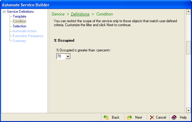

  3. Select 70 from the drop-down list:

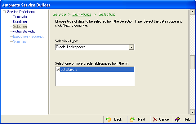

  4. Select Oracle Tablespaces from the drop-down list and check All Objects:

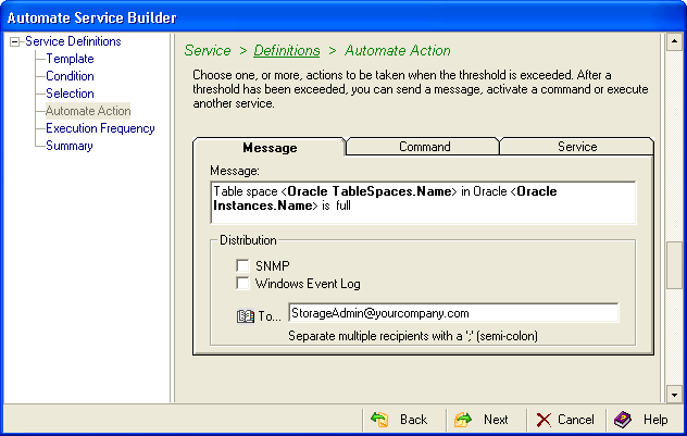

  5. Enter the message that you want to be sent when the conditions have been met in the Message text box. Enter your e-mail address in the To… text box:
