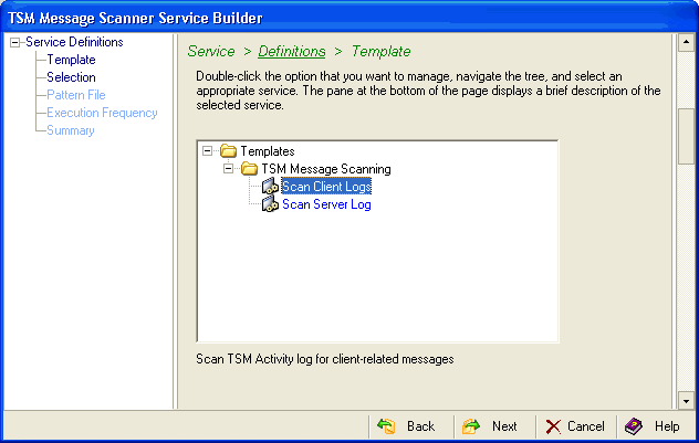

- From the TSM Message Scanner table main menu, select Configuration, New. The Template dialog of the TSM Message Scanner Server Builder Wizard opens. Expand TSM Message Scanning and select Scan Client Logs:

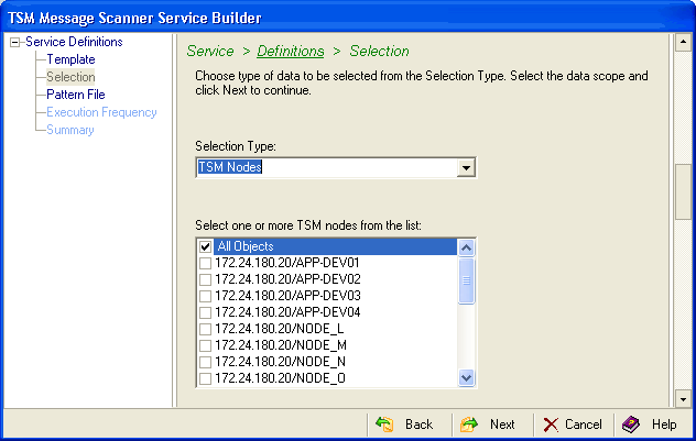

- Select TSM Nodes from the Selection Type drop-down list and check the boxes next to the objects that you want to scan for failures:

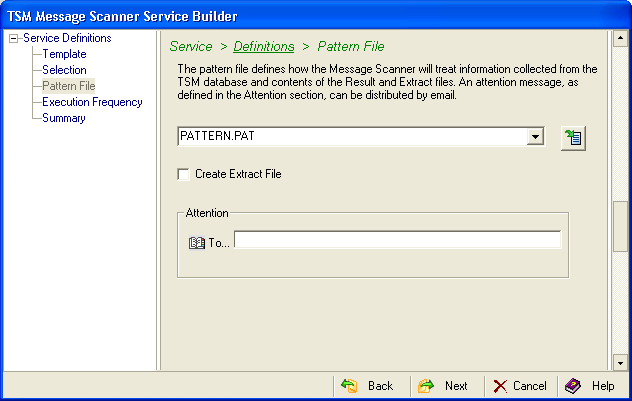

- Enter the e-mail address that you want the attention sent to in the To… text box. Check the Create Extract File box to save log entries that contain the lines that are not excluded by matching patterns:
Note: You can edit the patterns file directly by clicking

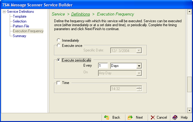

- Define when or how often you want to execute this service:
