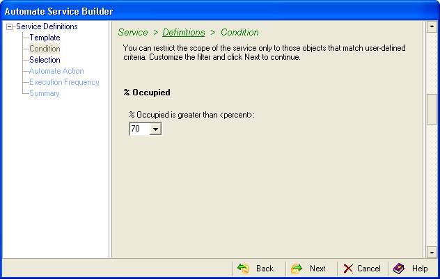

- Select 70 from the drop-down list:

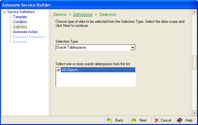

- Select Oracle Tablespaces from the drop-down list and check All Objects:

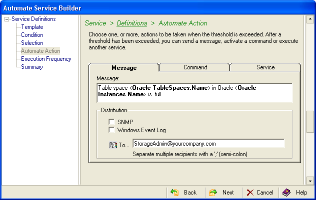

- Enter the message that you want to be sent when the conditions have been met in the Message text box. Enter your e-mail address in the To… text box:

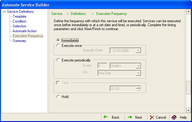

- In the Execution Frequency dialog select Immediately:

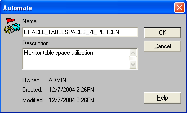

- Enter a name for the service in the dialog. You can also provide an optional description. When you finish, click OK. The service executes or saves depending on what you selected in the previous dialog:
