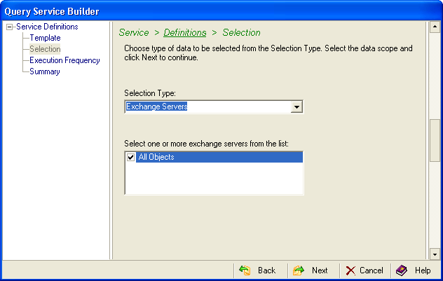

- Select Exchange Servers from the drop-down list and check All Objects:

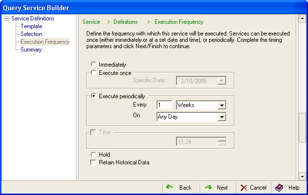

- Select Execute periodically, enter 1 in the Every text box, and select Weeks from the drop-down list. Check the Retain Historical Data check box:
Note: CA SRM collects historical data to calculate trend information.

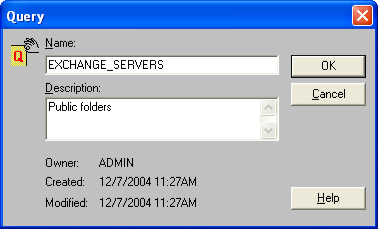

- Enter a name for the service in the dialog. You can also provide an optional description. When you finish, click OK. The service executes or saves depending on what you selected in the previous dialog:
