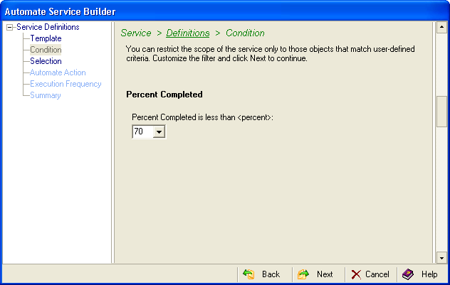

- Select 70 from the drop-down list:

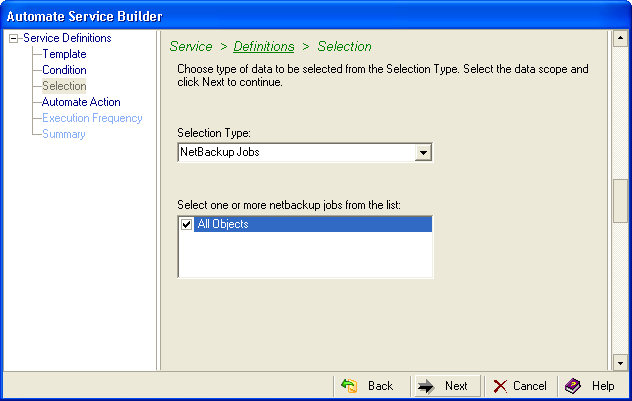

- Select NetBackup Jobs from the drop-down list and check All Objects:

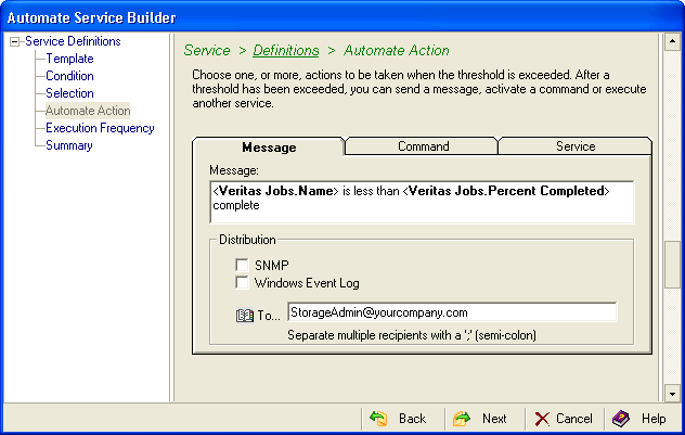

- Enter the message you want to send in the Message text box. Enter your email address in the To… text box:

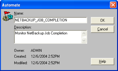

- Enter a name for the service in the dialog. You can also provide an optional description. When you finish, click OK. The service executes or saves depending on what you selected in the previous dialog:
