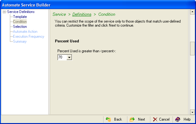

- Select 70 from the drop-down list:

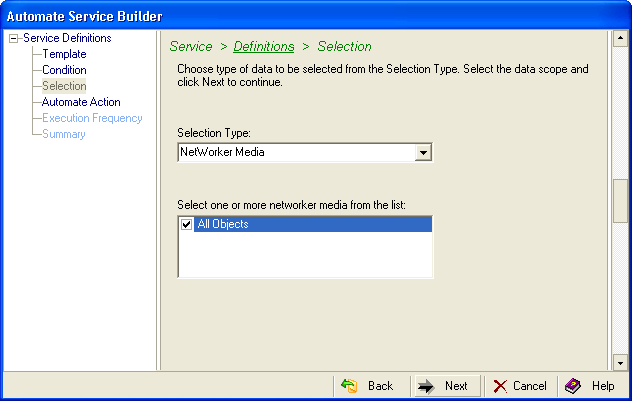

- Select NetWorker Media from the drop-down list and check All Objects:

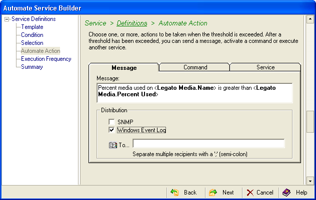

- Enter the message you want to send in the Message text box. Check the Windows Event Log check box:

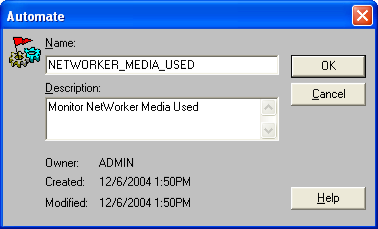

- Enter a name for the service in the dialog. You can also provide an optional description. When you finish, click OK. The service executes or saves depending on what you selected in the previous dialog:
