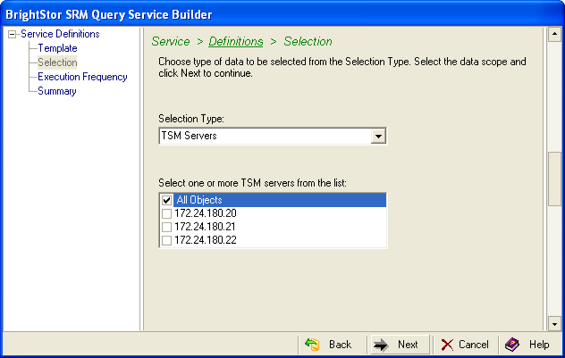

- Click the Configuration menu and then New in the Query table. The Query Service Wizard opens. From the Query table main menu, select Configuration, and New. Expand Backup Products, then Tivoli Storage Manager, and select Servers.
- Select TSM Servers from the drop-down list and check All Objects:

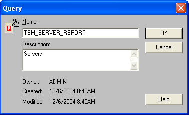

- Enter a name for the service in the dialog. You can also provide an optional description. When you finish, click OK. The service executes or saves depending on what you selected in the previous dialog:
