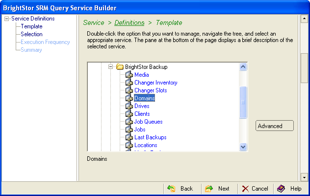

- Click the Configuration menu and then New in the Query table. The Query Service Wizard opens. Expand Backup Products, then CA ARCserve Backup, and select Domains:

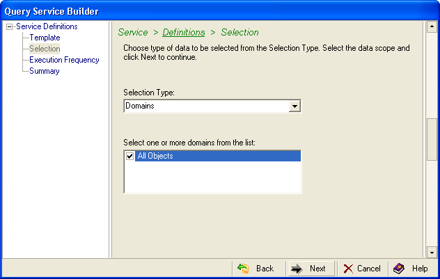

- Select Domains from the drop-down list and check All Objects:

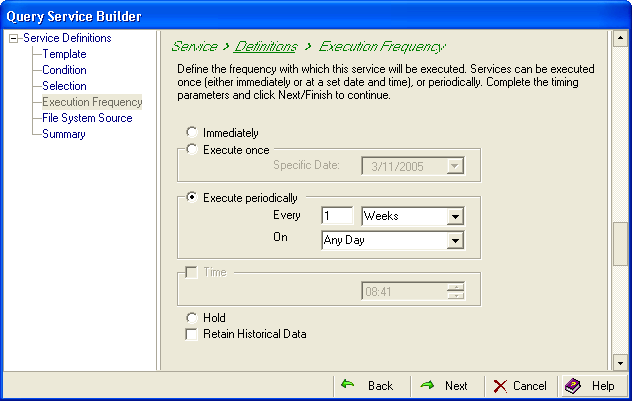

- Select Execute periodically. Enter 1 in the Every text box and select Days from the drop‑down list. Check the Retain Historical Data check box so that CA SRM collects historical data:
Note: CA SRM uses historical data to calculate trend information.

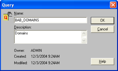

- Enter a name for the service in the dialog. You can also provide an optional description. When you finish, click OK. The service executes or saves depending on what you selected in the previous dialog:
