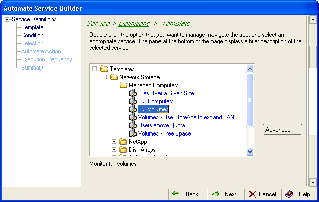

- Click the Configuration menu and then New in the Automate table. The Automate Service Wizard opens. Expand Network Storage, Managed Computers, and select Full Volumes:

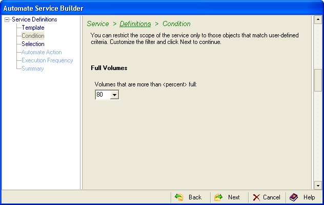

- Select 80 from the drop-down list:

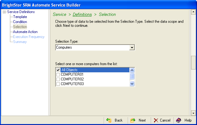

- Select Computers from the Selection Type drop-down list and check All Objects:

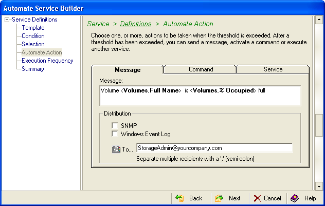

- Click the Message tab. There is a default message based on your previous selections. You can add to this by clicking in the Message text box. Enter your email address in the To… text box:

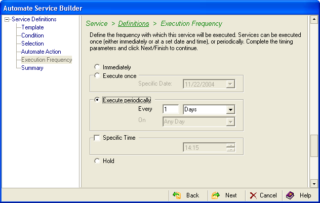

- Select Execute periodically and enter 1 in the Every text box. Select Days from the drop-down list:

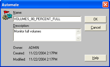

- Enter a name for the service in the dialog. You can also provide an optional description. When you finish, click OK. The service executes or saves depending on what you selected in the previous dialog:
