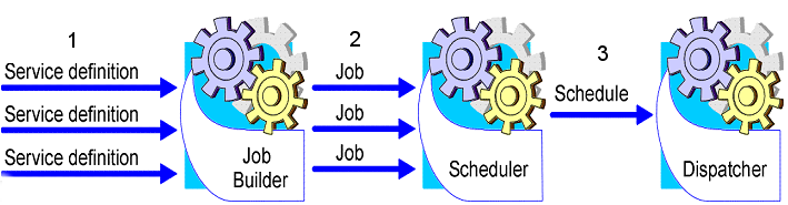

CA SRM uses an internal construct called a job to execute services. A job is the translation of a service request into a set of executable steps. Jobs are not visible to the user, but understanding how CA SRM uses jobs can help explain the principles on which CA SRM bases the scheduling of services.
A job is comprised of tasks. A task is a program that performs a portion of the job's work.
All jobs are input to the Scheduler, which checks their timing conditions and determines the time interval within which the next execution of the job must take place. The following example shows the sequence of events:
The Dispatcher verifies the actual availability of the required resources at the time of scheduled execution and executes the steps that make up each job.
When you submit a service or procedure for scheduling, the Scheduler checks the last time CA SRM executed the job and the current date and time, and determines the intervals within which the next execution of the job must take place. For example, if the timing of a service requires that the job run every Tuesday and Thursday after 17:00, and if the current day is Wednesday, the next execution of the job must take place on Thursday between 17:00 and 24:00.
Note: The scheduler does not check resource availability. Because resource availability changes from day-to-day and from hour-to-hour, the Scheduler cannot guarantee that the job will execute at the scheduled time, only that the Scheduler will submit the job for execution at that time. A job execution priority scheme ensures jobs that already started can complete before a new job starts.
When a job completes execution, it reschedules for the next execution according to its timing condition.
