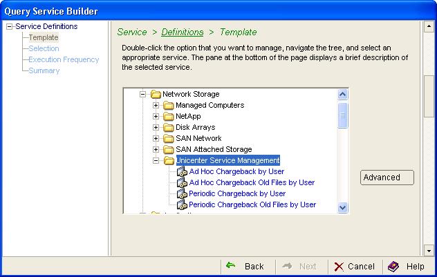

To create the query in CA SRM, follow these steps.

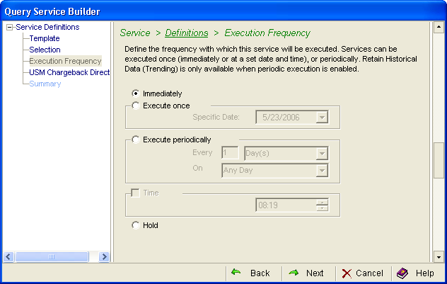

If you select Weeks, you can choose a specific day in the On box. The On box is inactive for the other frequencies.
The Retain Historical Data (Trending) option is only available when you enable periodic execution.
If you want to collect at a specific time check this box. This only works in conjunction with the Execute once and Execute periodically options. Use the spin box to designate the time of day you want the collection to occur.
Hold—This option keeps the service available but the service does not run. It remains on hold until you change the option to one of the frequencies listed above. You can use the Hold option for situations where you want to kickoff this service from outside of CA SRM using the command line option. Hold is not available for every service.

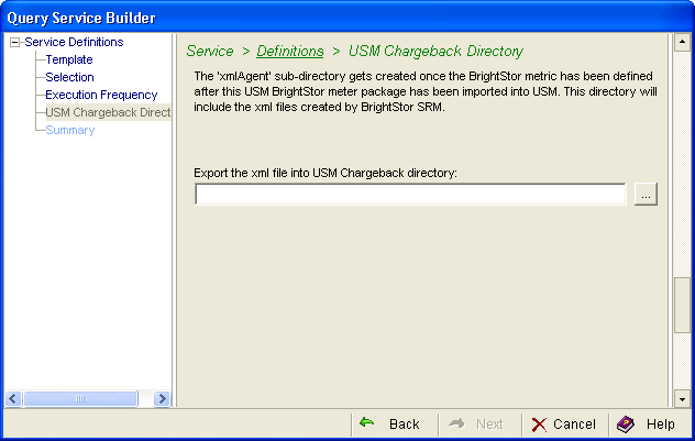

If CA SRM finds Unicenter Service Accounting on the local machine, CA SRM provides a default directory.

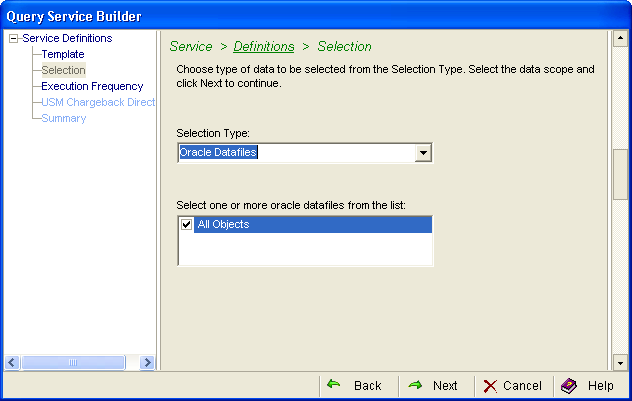

The query creates a file name that looks like this: BS_Chargebackxx.xml. The xx is the object name. So in the preceding example the file name generated by the query is BS_ChargebackOracleDatafiles.xml.
