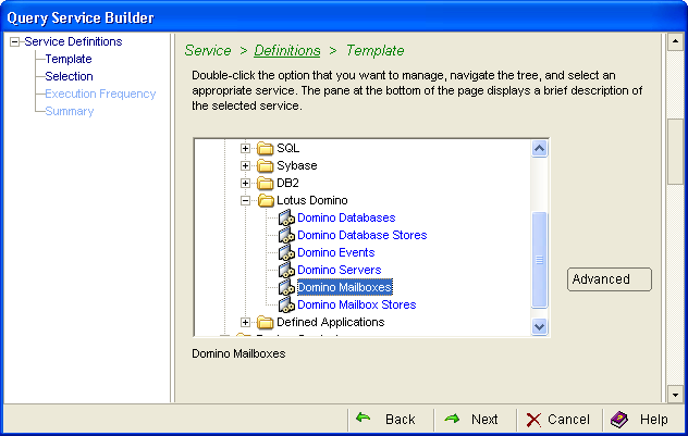

- Click the Configuration menu and then New in the Query table. The Query Service Wizard opens. Expand Templates, Applications, Lotus Domino, and then select Domino Mailboxes:

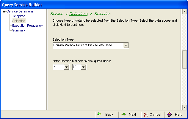

- Select Domino Mailbox Percent Disk Quota Used and then designate the percent of the quota:

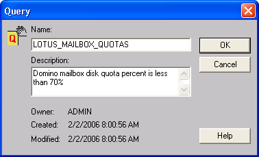

- Enter a name for the service in the dialog. You can also provide an optional description. When you finish, click OK. The service executes or saves depending on what you selected in the previous dialog:
