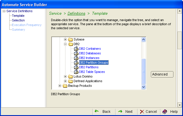

- Click the Configuration menu and then New in the Query table. The Query Service Wizard opens. From the Query table main menu, select Configuration, New. The Template dialog opens. Expand Applications, DB2, and then select DB2 Partition Groups:

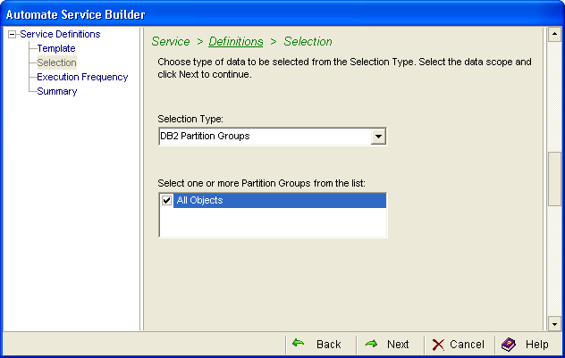

- Narrow the scope of the query by selecting the type from the drop-down list and then check the specific objects you want queried by the service:

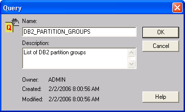

- Enter a name for the service in the dialog. You can also provide an optional description. When you finish, click OK. The service executes or saves depending on what you selected in the previous dialog:
