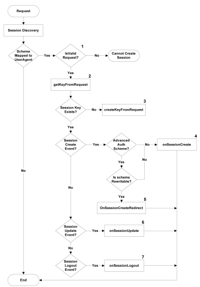

The following illustration shows the process flow for the session scheme API methods.
The methods identified in the illustrated are:
- isValidRequest—This method must be implemented in a custom session scheme to determine and verify the conditions that make up a valid request.
- getKeyFromRequest—This method must be implemented to extract a key from a valid request. If no key is present, the createKeyFromRequest method is called.
- createKeyFromRequest—This method must be implemented to trigger the creation of a key for a new session.
- onSessionCreate—On the event of session creation, if the session scheme in use is not rewritable, this method is called. This method may be implemented with any code that should be triggered at the inception of a new session.
- onSessionCreateRedirect—On the event of session creation, if the scheme is rewritable, this method is called. This method may be implemented with any code that should be called at the inception of a new session for a rewritable session scheme.
- onSessionUpdate—A session is updated for each new request made during the session. This method is called during each session update. It may be implemented by adding any code that should be triggered during a session update.
- onSessionLogout—This method is called when a session is terminated. It may be implemented with any code that should be executed when a user session is terminated.
