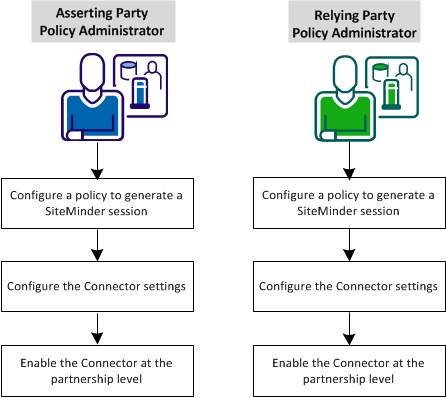

The following figure shows the configuration process when integrating with the Connector:
Complete the following configuration steps:
