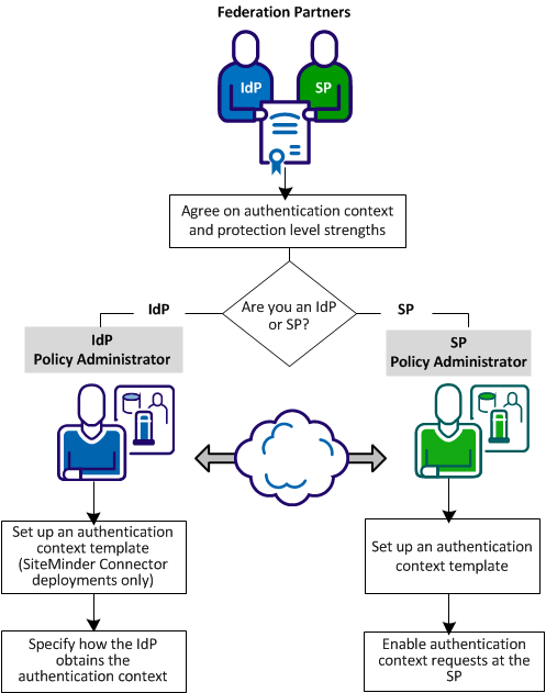

The following figure shows the configuration process for each partner. CA SiteMinder® Federation Standalone does not have to be installed at each site.
Process for configuring authentication context
Complete the following steps to configure authentication context processing:
  1. Agree on authentication context and protection level strengths.
  2. Set up an authentication context template.
  3. Complete the task for your site:
