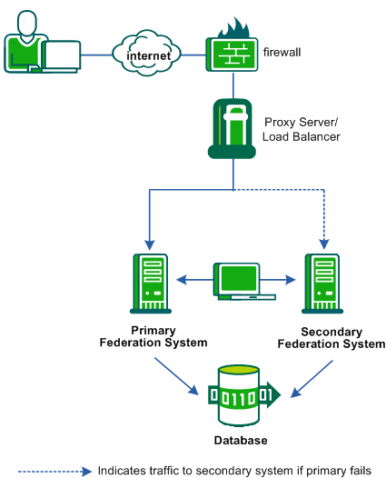

The following figure shows a CA SiteMinder® Federation Standalone deployment with failover. If the primary system fails, transactions are directed to the secondary system.
Graphic illustrating failover between the primary and secondary systems
As shown in the previous figure, CA SiteMinder® Federation Standalone is installed on two machines that use the same database.
