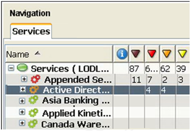

Color-coded icons on the Operations Console indicate CI severity (the color-coded icons for services indicate the service impact). Alerts in the Contents pane have the color corresponding to their severity. The Navigation pane also represents severity in columns next to services and CIs. The following graphic shows that each column lists the number of items with the corresponding severity (represented by the colors in the previous table).
Severity
Note: If no alerts are raised for a CI, its severity is green even if the device contains child CIs with different severities. Also, groups are simply containers and would not usually have alerts. You can expand the tree and can follow the numbers to the row that lists the item whose severity you are looking for.
