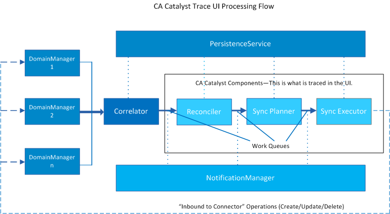

The following diagram shows the processing flow:
The components in the diagram are explained as follows:
- Reconciler: Creates or updates the reconciled view of a CI.
- Sync Planner: Creates a synchronization plan based on the changes to the reconciled view.
- Sync Executor: Executes the synchronization plan.
The actions that are involved in the process are as follows:
- Dequeued: Specifies that the component has taken a notebook off the work queue for processing.
- Processed: Specifies that the component has completed working on the notebook.
- Error: Specifies that the component has encountered an error while trying to complete work on the notebook.
- Retry: Specifies that the component has decided to retry work on the notebook at a later time due to a recoverable error.
- Email: Specifies that the component has stopped trying to complete the work, either due to an unrecoverable error or because it has retried a maximum amount of time. By default, a component stops after retrying for 25 minutes, with a retry interval of 1 minute.
