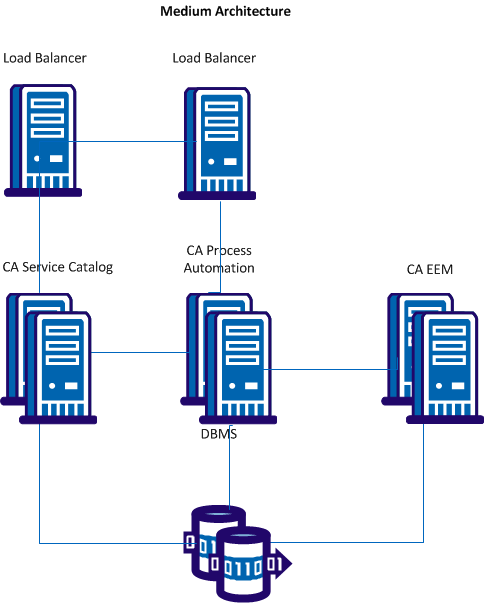

The medium architecture expands the small architecture by implementing clustering and adding load balancers, as follows:
The medium architecture setup follows. Each mention of two clustered servers refers to two virtual computers that are clustered.
- Two clustered servers host CA Service Catalog.
- Two clustered servers host CA Process Automation.
- One or preferably two load balancers are the front ends to the clusters for CA Process Automation and CA Service Catalog, respectively. Both the CA Process Automation and CA Service Catalog clusters require a load balancer, which can be an existing instance. CA Process Automation and CA Service Catalog can share a load balancer.
- Two clustered servers host CA EEM. CA EEM is clustered but is not used with a load balancer. We recommend clustering CA EEM to provide failover protection. You use configuration parameters to connect CA Service Catalog and CA Process Automation with the CA EEM cluster. You can increase CA EEM performance by pointing each CA Process Automation domain server to different CA EEM servers.
- Two clustered servers host the DBMS.

The medium architecture can efficiently process a load of 11-50 catalog requests per minute. This architecture provides a good starting point for most implementations. You can monitor performance and you can add clustered instances, if necessary.
