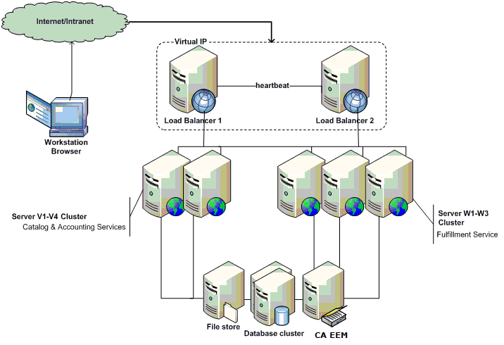

  5. If clusters do not run efficiently, verify that this communication exists and check for any network configuration problems. For example, in the following diagram, all the computers V1-V4 and W1-W3 clusters must be able to run the “telnet loadbalancer portno” command.
    For example, suppose your load balancer host name is abc and the port is 89. In that case, verify that you can successfully connect from all your clustered nodes. To do so, enter the following command from each node:
    telnet abc 89
    This picture specifies a suggested clustering setup with communication between all load balancer computers, all CA Workflow clusters, and all Service View clusters
