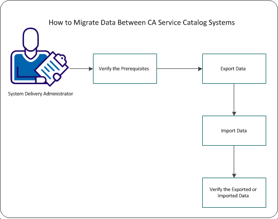

The following diagram shows the process of migrating data between the CA Service Catalog systems.
BCSC--Migrate Data using IXUTIL UI--W
Complete the following procedures to migrate data between CA Service Catalog systems using IXUTIL:
