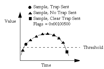

The following illustration shows how the agent would send and clear traps based on this monitor directive.

The following illustration shows how the agent would send and clear traps based on this monitor directive:
