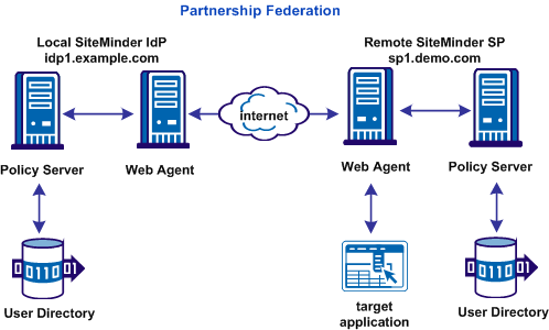

The initial partnership that you are creating represents the following sample network. The URLs in the procedures and sample network are examples and do not resolve to any real site.
http://idp1.example.com:9090/affwebservices/public/saml2sso
Assertion Consumer Service URL at the SP
http://sp1.demo.com:9091/affwebservices/public/saml2assertionconsumer
Note: You need two systems with CA SiteMinder® installed to implement this sample network.
The following figure shows the sample partnership with CA SiteMinder® at both partners.
